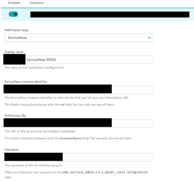

We're using the ServiceNow integration sending into ITSM. Screenshots of that config are below.

It depends which integration you are using. Can you share some screenshot?
For example, if you use custom integration, you can turn off this flag:

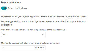

Agree with @AntonPineiro here, but you can also look at the types of alerts that are being created. A lot of the anomaly detection settings and definitely the metric events have a "dealerting" threshold that is configurable. You may want to look there as well.
Observability Engineer at FreedomPay
I didn't think to check there. I was going through the documentation and our env. I think this is what I'm looking for.
