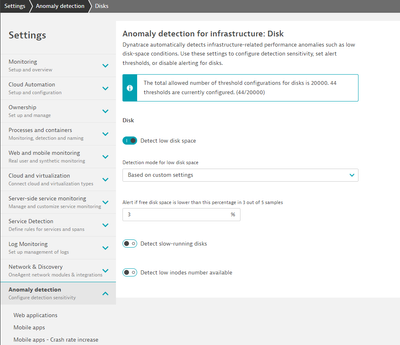

Hi
In the Settings Anomaly detection Disks
you can find the bellow configuration (for all hosts, disks)_.
You can do the same in the host level.

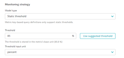

1. Disk space between 85 to 90
  Metric Selector
builtin:host.disk.usedPct:filter(and(or(in("dt.entity.host",entitySelector("type(host),entityName.equals(~"HOST_NAME~")")))),series(avg,and(ge(85),le(90)))):splitBy("dt.entity.host"):parents
Config in Metric Event (Monitoring strategy)
Since the metric only brings values in that interval, the metric will warn exactly when there are values greater than 85.

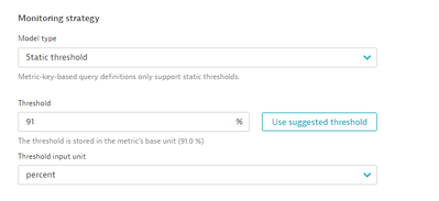

2.Disk space greater than 90
builtin:host.disk.usedPct:filter(and(or(in("dt.entity.host",entitySelector("type(host),entityName.equals(~"HOST_NAME~")"))))):limit(20)
