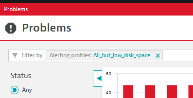

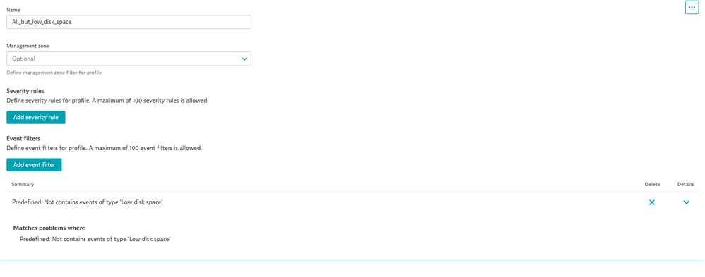

Or, you can create an Alerting profile, that captures all your problems, but the low disk space, then use this as problem filter.
Alerting profile:
as problem filter
