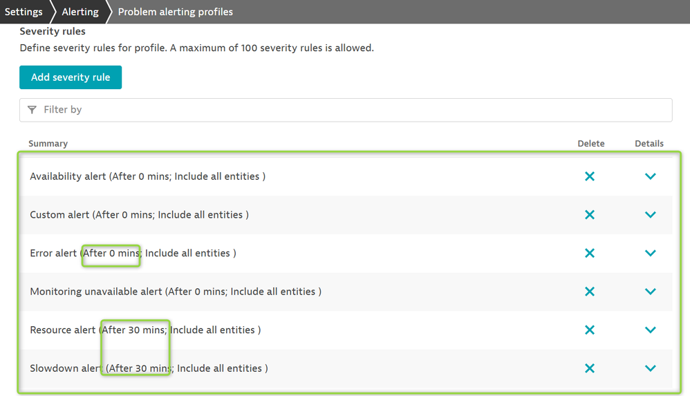

Hi @Maheedhar_T
If you seek delaying the reported alerts, you can increase the "Delay" timing within the configured severities among the alerting profiles.
Also from ServiceNow side you can validate the same concern if it's configurable from its end would be an added value.
Hoping it helps.
BR,
Peter
