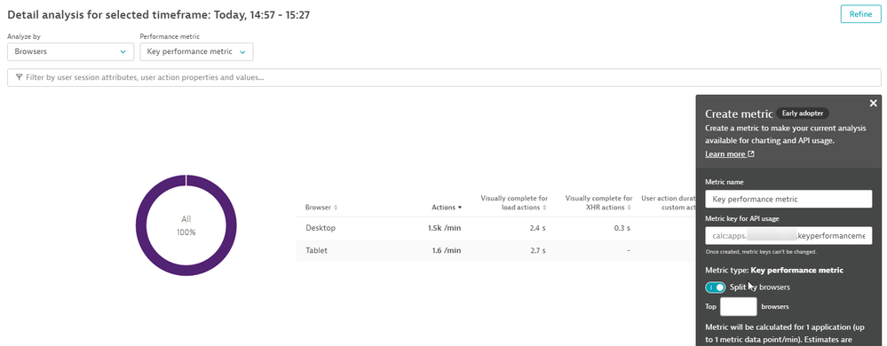

You can leverage the metrics for the application page to give you the results by application:
i don't think you can from the session segmentation but that would be a great RFE
