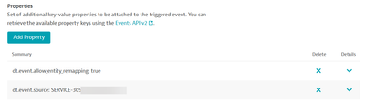

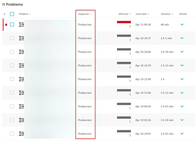

Hello, I find that in many problems, the impacted entity is the tenant / environment. This happens with SLOs, log alerts, among others.
Looking for a way to remap these to the corresponding or desired entity, I configured two properties in the metrics events:
  • dt.event.allow_entity_remapping with a value of true
  • dt.event.source where I specify the desired entity.
Although when the issue occurs, the dt.event.source entity is reported in the description, I still see the environment as impacted, and this doesn't help the troubleshooting teams.
