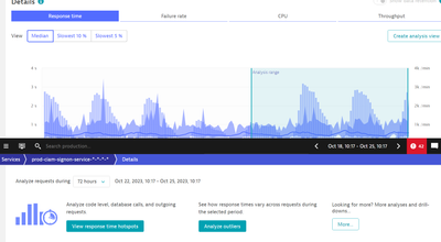

I would like to use Dynatrace causation correlation feature as described below.
Davis® causal correlation analysis | Dynatrace Docs
I am unable to see 'analysis' as shown in link above.
Could someone guide?
Thanks

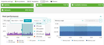

Hi @vchandna  what exactly is not working for you?
To select the appropriate time range for a particular graph, click on it and select the time you want to analyse.

01 Nov 2023 05:31 PM

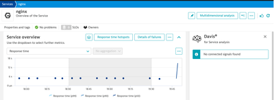

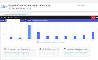

I don't see the same 'analyze' option as shared in documentation ( Davis® causal correlation analysis | Dynatrace Docs). When I click on 'Analyze Outliers' it doesn't seem to show Davis output
01 Nov 2023 06:50 PM

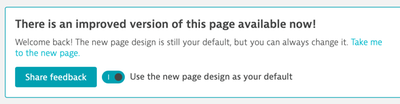

This features works only in the new unified analysis screens, so right now it is host screen, kubernetes, service or extensions based on EF2.
07 Nov 2023 07:25 AM
Thanks. Worked in new mode

01 Nov 2023 06:53 PM
If you have the new tab view enabled then everything works without a problem:) I checked for services, kubernetes and host.
