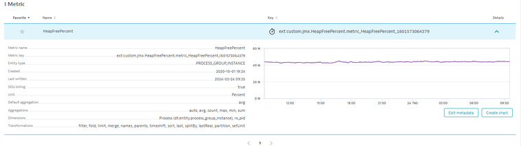

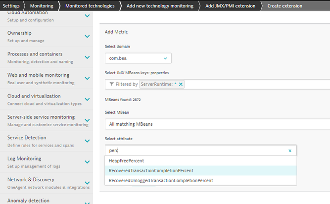

Option two: You can find some technology specific jmx metrix for it at the different techologies. Eg. one of my technology is weblogic. I really like to use the heap free percentage metric.
