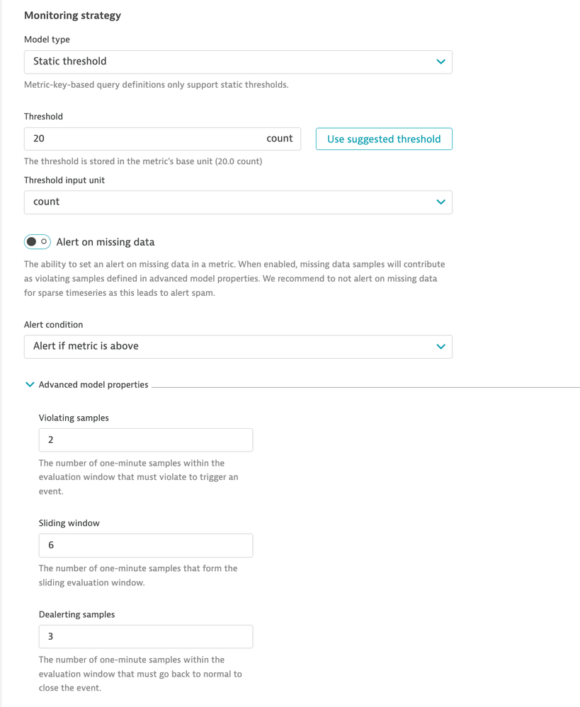

First of, the minimum sample value for de-alerting is 3, so you can trigger an alert when count is higher than 20 for 2 min in 6, but the problem solving will be set if lower than 20 for 3 min in 6.
Example:

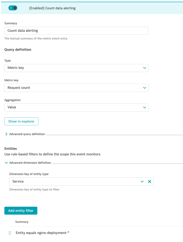

For this example I am using the builtin metric for service request count, and filtering for one single service. So the data is coming every 1 minute. The calls to my service is being getting every one minute.
You should take the metric type in consideration too. This builtin metric already aggregate the data as count, so this makes the thing easy.
Can you share with us the metric you are using?
Then, you can just create an alerting profile that filter for this metric event name to use it in the email problem notification.
