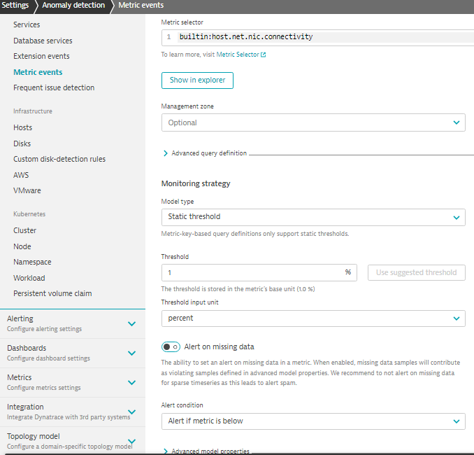

31 Oct 2023 02:22 PM - edited 31 Oct 2023 02:22 PM
Hello,
Not sure if this is going to work for you. But you may try if this suits your requirement.
As far as I know no metric available for nic down but alternatively you could set  builtin: nic connectivity below 1% as anomality detection
Check below settings
Cheers!
RN
