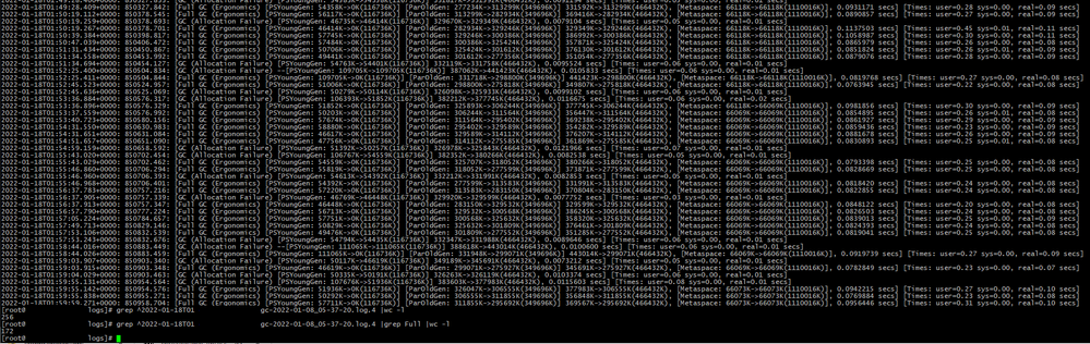

One of our applications that Dynatrace monitors recently had 172 Full GCs in a one hour period.
256 garbage collections were performed in a one hour period and 172 of those (67.1875%) were Full GCs.
While our organization does not subscribe to Dynatrace's log monitoring, you can see from the verbose garbage collection log that indeed, 172 of 256 GCs in a one hour window were Full GCs.
