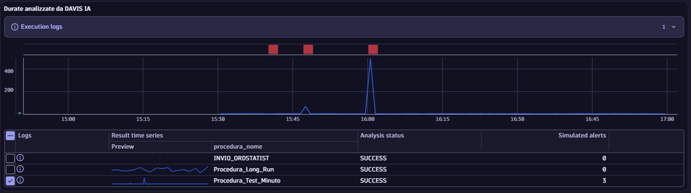

Hi everyone,
I have just created an anomaly detection rule using a DQL query and the Davis Analyzer, starting from this dashboard tile.Immagine 2026-01-20 170707.png
As you can see, there are three simulated alerts, therefore the detection condition is met.
The problem is that I can’t find this alert either in the Problems section or as a dt.davis.event / dt.davis.problem.
Our goal is to notify users whenever this condition is met.
Is there anything I can do to achieve this?
Thanks a lot,
Andrea

AntonPineiro
Maybe it is an issue in the evaluation window time. I would open a support ticket.
Best regards
Hi, thanks a lot. We identified an issue related to the evaluation window time. Specifically, when a sliding window of 1 minute is configured, the davis.event is not generated and the problem is not raised. When the window is set to values greater than 2 minutes, the detection works as expected.

IMO  this behavior is expected and it’s not a bug.
The key point is that “Simulated alerts” shown from a dashboard/notebook context are simulation results, not production alerts. Dynatrace explicitly describes this as Notebook & Dashboard Simulation in Davis AI limits (simulation per Davis analyzer execution).
https://docs.dynatrace.com/docs/discover-dynatrace/platform/davis-ai/reference/davis-ai-limits
These simulated alerts only confirm that the detection logic would have triggered on historical data.
Because it’s a simulation/validation run, it won’t necessarily create Problems or corresponding dt.davis.problem / dt.davis.event entries.
When you create an anomaly detection rule from a dashboard tile / DQL Analyzer, Davis runs in simulation mode only.
Simulation is not production alerting.
Yoiu should try turn your DQL result into a metric and then use Metric events (custom alerts)
