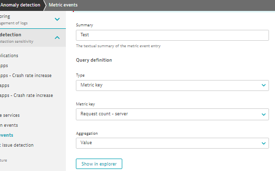

I want to open discussion,
What is the best way to set a metric event for a pecific service/request:
Example: sent email if the count of the service A is above 500 in the last 1 Hour.

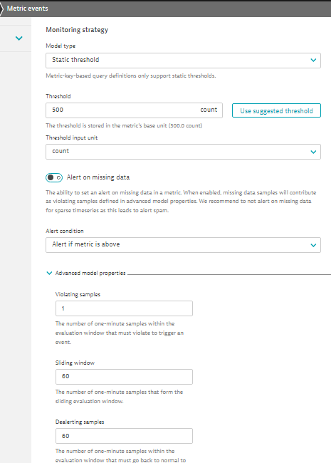

Hello @Malaik
Normally I might go with something like this.
set threshold as 500 violate 1 time during the sliding window of 60min (not sure 60 dealerting will help here)
Thanks
RN
22 Nov 2023 08:41 AM
Thanks,
But Im not sure that the suggested solution will work.
What i want is not that this threshold (500) was met 1 time in 60mn but I want the count of that metric in 60mn will not exceed 500.
may but 1 time 200 and second time 400, in that case i should raise alert which will not work with that solution
Thanks Chad,
