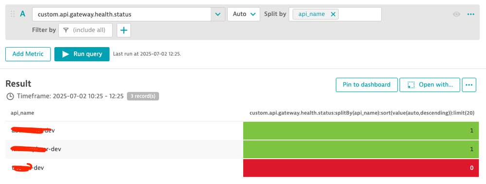

03 Jul 2025 06:34 AM
And a similar format doesn’t work for you when searching in the Data Explorer?
You can then specifically define the services you want to monitor — you can use the same selector in the metric event as well.
custome.api.gateway.healt.status:filter(and(or(in("api_name",entitySelector("type(api_name),entityName.equals(~"Entity 1~")"))))):splitBy("dt.entity.process_group_instance"):sort(value(auto,descending))
