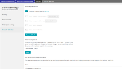

Hi Malaik,
I know that I have already answered this question in your other Forum post, but I thought I would provide the answer again here as well in case others view this thread and may benefit from it.
You can define thresholds for Key Requests in the Anomaly Detection settings of the service itself. As shown in this screenshot:

Thanks for your feedback.
But that is easy, and this is for the global service which is not the case here.
We asked for the request which is a part for the global service.
