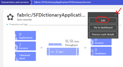

Hi Malaik,

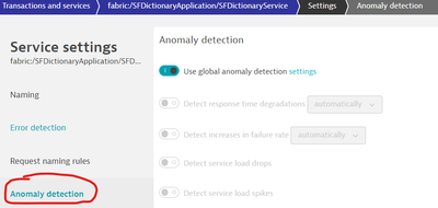

You need to go to the Settings page of the service the key request belongs to (find the service, then next to the name click on the button with "..." then Edit")
Then on the left select the "Anomaly Detection" section.
At the bottom of that section, you should be able to see the list of key requests defined for that service, and you can modify the thresholds for them as needed, just toggling on the specific threshold you want to set:
Regards,
Álvaro

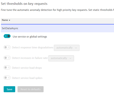

Hello @Malaik
Simply switch off the global button of the key request and configure the baseline or static thresholds according to your need for the key request. The following is an example.
Regards,
Babar

Hello @Malaik
In the anomaly settings, go to the bottom to access the key request.
Regards,
Babar
