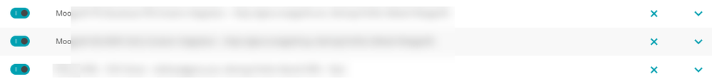

we have noticed the Filtering of values in the Problem Notifications page appears to be broken. When we search for "moo" I should see a bunch of integrations:
But if I browse through, I can see it:
Can anyone else confirm this issue as well? we are on Cluster 1.218.94.20210604-221534

@ct_27 interesting. We just got 219 as well and we are still having an issue where if I Type "Webhook" nothing comes up, but if I click through all the pages and then search for it, it will come up with 4 entries. really odd.

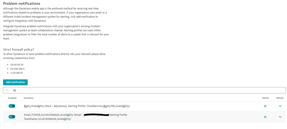

I have exactly the same issue;
version 1.218.105.20210611-135859
Tried on both Edge and Chrome.
I have 22 pages of notifications defined so roughly over 500
The filter is only working for the data on the pages that i have "loaded".
So when i enter the Problem Notifications screen, the filter will only work on the items listed on the first page.
When i then go to for instance page 4, the filter will work on the notifications on page 1 and page 4.
So the workaround is to first walk through all the pages on your "Problem notifications" screen.
And you have to redo that every time after you leave the screen
