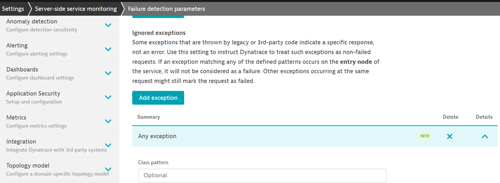

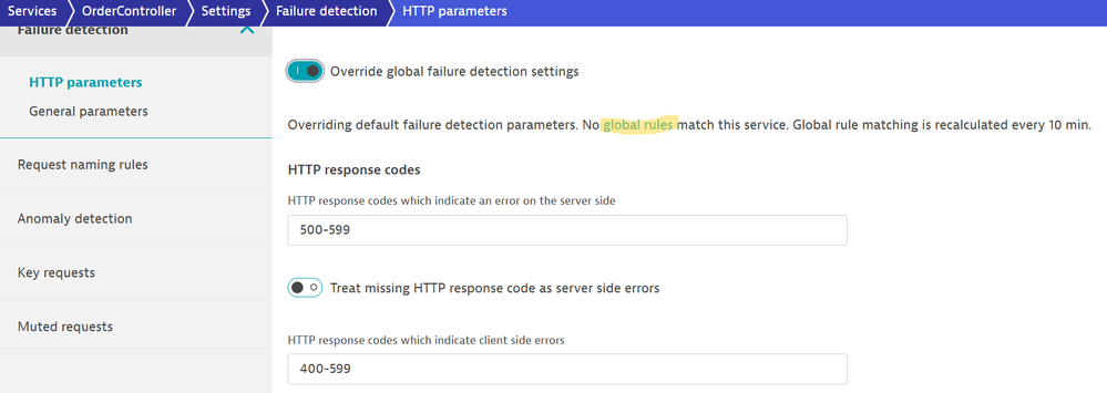

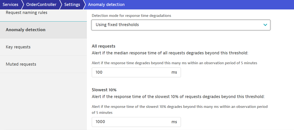

need to stop receiving exception alerts (40x) in monitoring for a certain service in a alert profile
I'm trying to do this using the failure/anomaly detection setting, but I'm stuck in the rules
I think that config should work.
