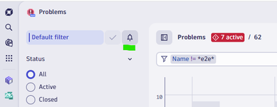

@henk_stobbe as far as I know another solution is in development. So alerting profiles as they are will be phased out.
That is completely right. We will introduce a license included notification possibility to replace the existing notification channels and alerting profiles. Of course we will only sunset the existing ones once the new feature has fully landed.
The plan at the moment is as follows:
- In October, the first license included one click notify me will appear directly in the new problems app, which sends out emails automatically. See the screenshot below:
- Next step then is to offer a general purpose 'Automate' action on top of this to allow you to call any REST endpoint or trigger any automation step. The plan is that this will also be license included as long as you stick to a 'simple' workflow with a single action. Once you start programming on top @r_weber it will become a workflow 😉
