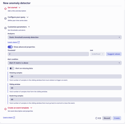

2. For your third condition, you will want to adjust the sliding window settings in the anomaly detector (Toggle Show advanced properties in the Customize parameters step):
60/60/* would correspond to what you are requesting. From experience, I would recommend a smaller time window though, as these slow acting alerts can feel a bit too sluggish. But up to you, of course!
