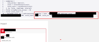

the filter that you see in the problem is not part of my query but its getting added and the reffered fields.unit_Str is not getting the field value referred , could you pls help here @t_pawlak
It looks like the additional filter (...) you see in the problem view is not coming from your DQL. Davis automatically adds a filter for the concrete time-series that triggered the event (based on the dimensions/placeholders used in the metric event).
Also, my previous suggestion with {fields.units_str} was misleading – fields.* placeholders are not supported in the event template, which is why you don’t see the value there.
In practice this means that if you reference units / units_str in the title/description, Davis will “pin” the problem to that exact value and will open/close a new problem every time the list of units changes. To have one problem per site, keep units only inside DQL (for filtering/logic) and use only {dims:site} (and standard placeholders like {value}) in the event template.
