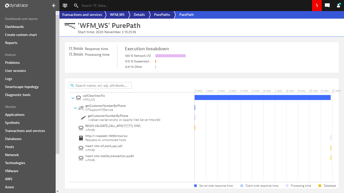

where's the delay belong as per attached we found NW IO, but no NW issue
mohamed_ebrahem
Newcomer
the above screenshot shows that was delay for 11.9 min, and i need justification for this delay

if you click the calls and select the '...' you should be able to see the method hotspots and get more information around the Network Break down
-Chad

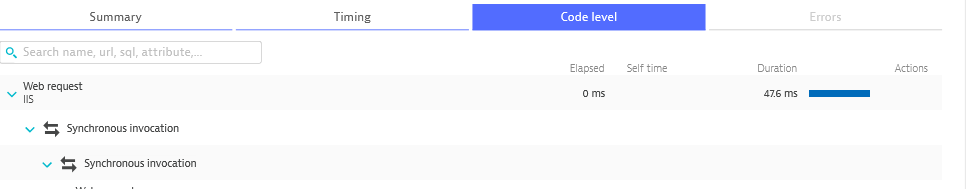

The code level view can also give some additional information:
Antonio Sousa
