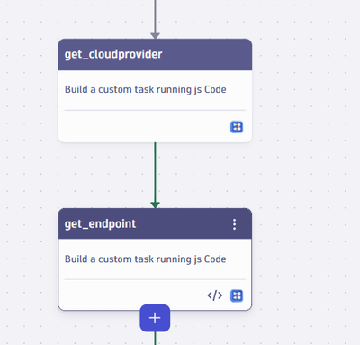

Hello, I do a check before running get_endpoint
{{ result("get_cloudprovider").cloudprovider in ["azure", "aws", "test"] }}
The result is that I get a no match, but when I check after the workflow run the value is ok and available.
Is there a way to add an await in a task Condition? And would this solve the issue?
KR Henk
07 Oct 2024 02:55 PM
Logic looks good. there is no need for an await. the task just needs to have get_cloudprovider task as it's predecessor in the conditions.
My best guess would be that there is some mismatch in the value of variable name.
could you share the result of get_cloudprovider in the execution as well as the condition mismatch screen.
07 Oct 2024 03:17 PM
Hello Christopher..
(As you explained to me before )-;
You are right, I used the wrong value, stupid me!
Thanks for you very fast support,
KR Henk
