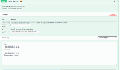

Maybe I am overlooking, but how can I add parameters to the API to start a workflow?
And how do I consume these parameters in js?

as mentioned in help, have you checked out swagger about how to add parameters to the workflow execution?
To access the input parameters, please have a look at this is the code snippet:

The parameters in that case will be logged to console.
