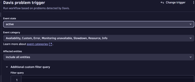

Hello Christian,
This is the trigger:
Sending you the top/important part of the JS task:

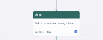

As written in https://community.dynatrace.com/t5/Automations/Davis-needs-time-to-store-events-and-problems-after-t... a wait time of 10 seconds (let's make it 15 seconds to be on the safe side) should be enough. In your code example, I believe you're missing the await statement.
export default async function ({ execution_id }) {
console.log('Starting to sleep');
const milliseconds = 15000; // sleep time
await new Promise(resolve => setTimeout(resolve, milliseconds));
console.log('Done sleeping');
Can you verify that the execution of the step that should sleep takes the expected amount of time, e.g., 15 seconds as in my example?
25 Jul 2024 02:45 PM
Hello Christian,
This will make your day, I have now a 20s wait,
No problems!
Thanks for you help and guidance!
KR Henk
