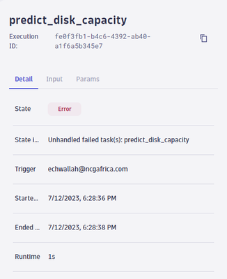

I am getting the below error while runnng the Davis® for workflows. on one of my environments.
I have followed word to word the steps on the documentation to Predict Disk Capacity and send message to Slack

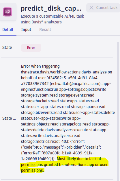

Error when triggering dynatrace.davis.workflow.actions:davis-analyze on behalf of user 'd24382c3-a50f-4d81-8fa4-a77033967342 (echwallah@ncgafrica.com)::app-engine:functions:run app-settings:objects:write storage:system:read storage:events:read storage:buckets:read state:app-states:read state:user-app-states:read storage:spans:read storage:bizevents:read state:user-app-states:delete state:user-app-states:write app-settings:objects:read storage:logs:read state:app-states:delete davis:analyzers:execute state:app-states:write davis:analyzers:read storage:metrics:read': 403: {"error":{"code":403,"message":"Forbidden","details":{"errorRef":"a6b6f165-e933-4253-8076-2917c7fcc971"}}}. Most likely due to lack of permissions granted to automations app or user permissions.
https://www.dynatrace.com/support/help/platform/davis-ai/automation#permissions
What could be causing this error and how do I resolve it?

Hi Community, any knowledge on what is causing the attached error and related logs?

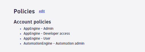

Additional information is that I am alredy a user with Account Admin and Deployment admin group priviledge. Within these group priviledges is already attached Policies for Automation Admin and App Admin as shown below

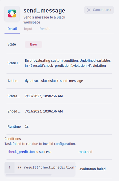

Hi Community, I have an update on this after selecting all the Primary and Secondary permissions under Authorization Settings.
I am getting the below error on the Slack send_message action
Error evaluating custom condition: Undefined variables in '{{ result('check_prediction').violation }}': violation

Hi Community, Thanks to DT Support Engineers, in the jscode for the predict_capacity line number 35 being the fix in the source code:
Changing that line to return {"violation": []} fixed this issue.
I think the documentation also needs to be changed accordingly for that use case
