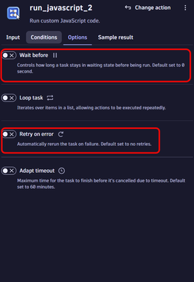

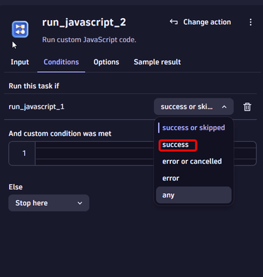

Hi, each task within a workflow waits for the previous one to finish before continuing to the next. What might be happening is that the workflow is skipping tasks when an error occurs.
To avoid this, you can choose one of the available options to ensure that a task only proceeds after the previous one has completed successfully.
Alternatively, you can configure settings such as increasing the wait time between tasks or enabling retries a certain number of times.
These options help guarantee that a task only executes once the preceding one has run as expected.
