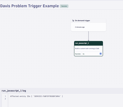

You can grab the event payload for event-triggered workflows from the execution params like this
import { execution } from '@dynatrace-sdk/automation-utils';
export default async function ({ execution_id }) {
  // your code goes here
  // e.g. get the current execution
  const ex = await execution(execution_id);
  const problem_event = ex.params.event
  console.log('Affected entity IDs', problem_event.affected_entity_ids);
Which would have a result like this

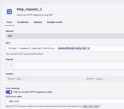

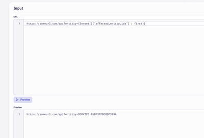

But you could also use it directly in other tasks in the input using expression, eg in the http request like this

Thank you for your fast solution. Especially the second solutions is more efficient than the intended way from me.
