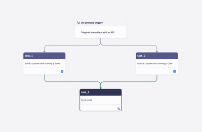

A task can have multiple predecessors. In order to add dependencies (the lines in the graph) you can click and hold the (+) icon and drag it onto the task you want to draw the line:
In this case, task_3 only runs once both task_1 and task_2 are finished.

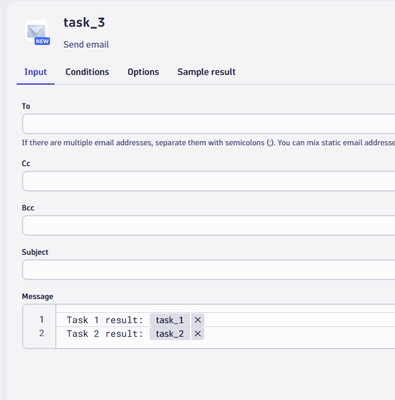

Task_3 then has access to both of their results as normal:

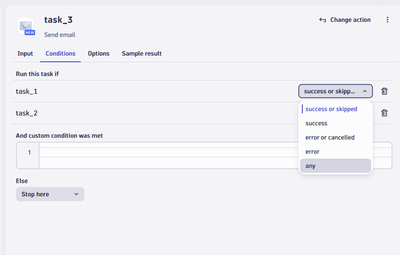

If however task_1 and/or task_2 might fail, and you still want to run task_3, then you have to adapt the conditions of task_3 accordingly (eg to any state, the color of the lines will change between red, green and black to indicate the dependency):
In this case, task_3 might run even though task_2 or task_1 or both failed and don't provide a result. You can use tools like if (https://docs.dynatrace.com/docs/platform-modules/automations/workflows/reference#if-statement) or default filter (https://docs.dynatrace.com/docs/platform-modules/automations/workflows/reference#filters)

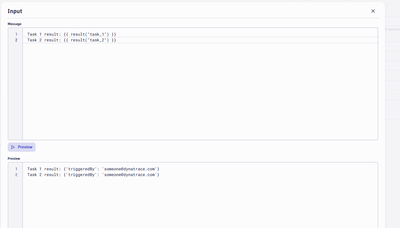

Correct, then you can check which one was successful. For this, you can use the task expression to get metadata on a task (Expression reference - Dynatrace Docs).
Example:
{% if task("task_1").state == "SUCCESS" %}
	Task 1 did run, result: {{ result("task_1") }}
{% else %}
	Task 2, result: {{ result("task_2") }}
{% endif %}
