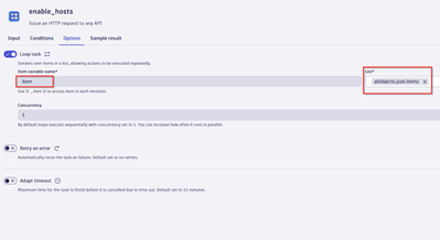

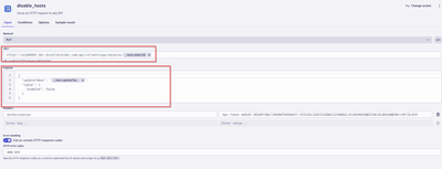

Then you can start creating the workflow. First you need to fetch all settings objects for the list of hosts you want to disable or enable with a http request task. The list of hosts is put in the URL and is comma separated. In the header section you add the Autorization details, please have a look at following screenshot
in the subsequent http request task you need to configure the loop task like this
The input for the tasks should be that
For this approach you have to create the token and manage it yourself.

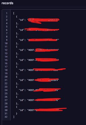

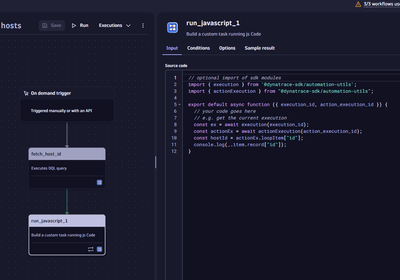

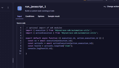

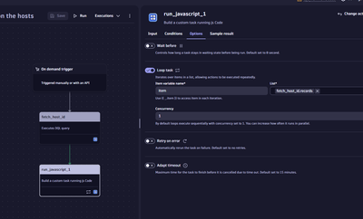

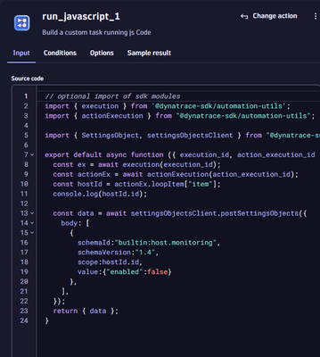

31 Aug 2024 02:48 AM
How do I iterate through all values from a fetch query using javascript?
31 Aug 2024 02:49 AM
here is the loop item
31 Aug 2024 03:20 AM
Thank You, I made it work for all tagged hosts.

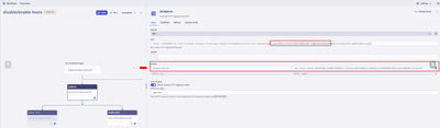

17 Feb 2025 07:30 AM
You have to use this header:
headers: {
'Accept': 'application/json; charset=utf-8',
'Authorization': 'Api-Token dt0c01.XXXXXXXXXXXXXXXXX'
like in this screenshot
sent by @sinisa_zubic in the first reply of this post.
Hope it helps.
