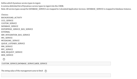

During the guided setup it's possible to fix some things based on management zones:
You could also set it up to use tags;
