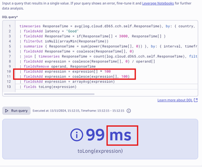

I'm building SLO vi DQL, skipping the standard SLO creation.
When I do so, I have the result in percentage but the result itself is expressed in the original unit for which the metric is calculate upon (millisecond).
How can I force the unit to change: not making it visibile or switch it with the symbol of a percentage?
Regards

Hi @y_buccellato ,
as you're working in notebooks, you'd probably have to make the notebook section aware of what unit you expect in the results. You can do that in the section options, units&formats.
My bad, just recognized that you're querying your objective within a guardian. Here, I'm afraid, there's no option to change this - I'll doublecheck with the team.
In any case, the result is correct; it seems the guardian's objective is just wrongly taking the unit of the first queried metric, but we will change the unit visualization.

Thank you Gerard, so far I understood the behavior of DT in SRG, inheriting the unit of measure from the metric I'm using.  Hope I can change the unit soon in SRG as the information applied with DQL make it become a percentage.
Do you know if I can already change this in DQL in notebook for example?
When I first run this query in Notebook it didn't appear to me that the result was inheriting the unit of measure. Also in Data explorer (I did this too with Metric Expression) the metric built seemed to be agnostic to unit of measure.

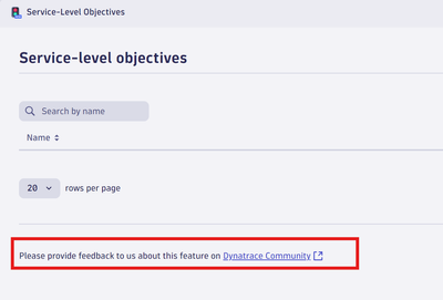

    When error happened I tried to click on the link to the feedback channel:
    but this just brought me to the general community page and I decided to go classica SLO cause I was not so acquainted with the new feature.

The team is already investigating how to address the display of units within the SRG objectives.
You can't change the unit itself in DQL. But, Notebook and Dashboard provide an option to override the displayed unit.
Thanks for the feedback regarding the new SLOs.
  • The community link will be updated to forward the user to this page: Feedback channel for the new service-level objectives app - Dynatrace Community
