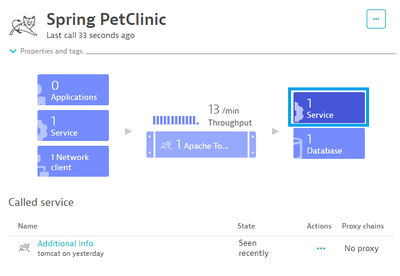

Custom service is great funcional.
This is how it looks:
After instrumentation Dynatrace will add service. You can find it in "called services".
in squares - additional information on the operation of methods instrumented using custom service
How exactly it takes - buildFeedMetadata method and buildFeedEntries
