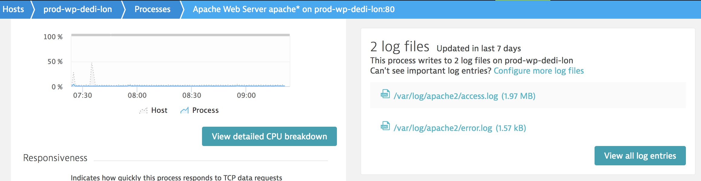

You could manually look at the processes and find the log and its size. It is not a timeseries so it cannot be tracked.

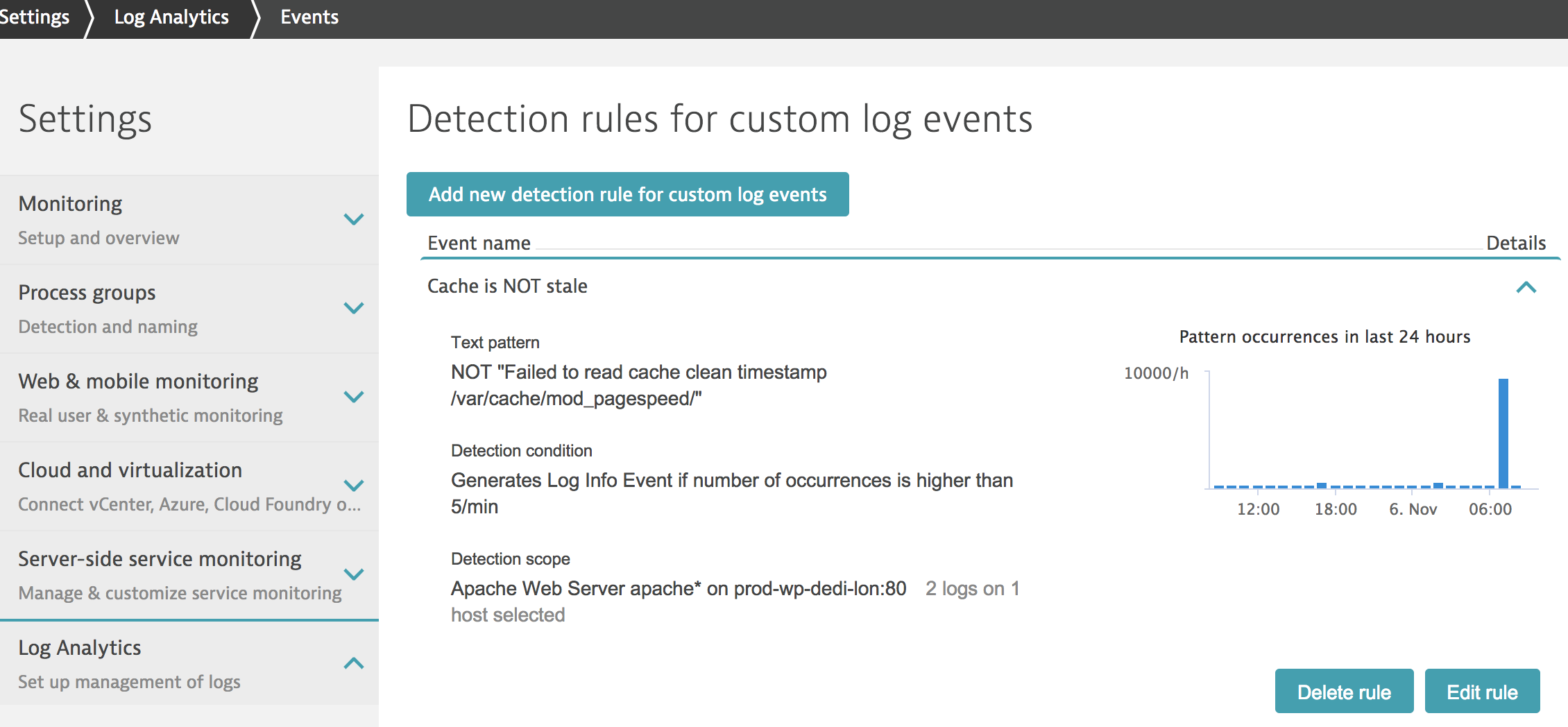

Typically, you will be using log event rules to identify events. Perhaps a solution for you is to define a log event and track this? (/#settings/logevents) This provides the pattern occurrences over time like below:

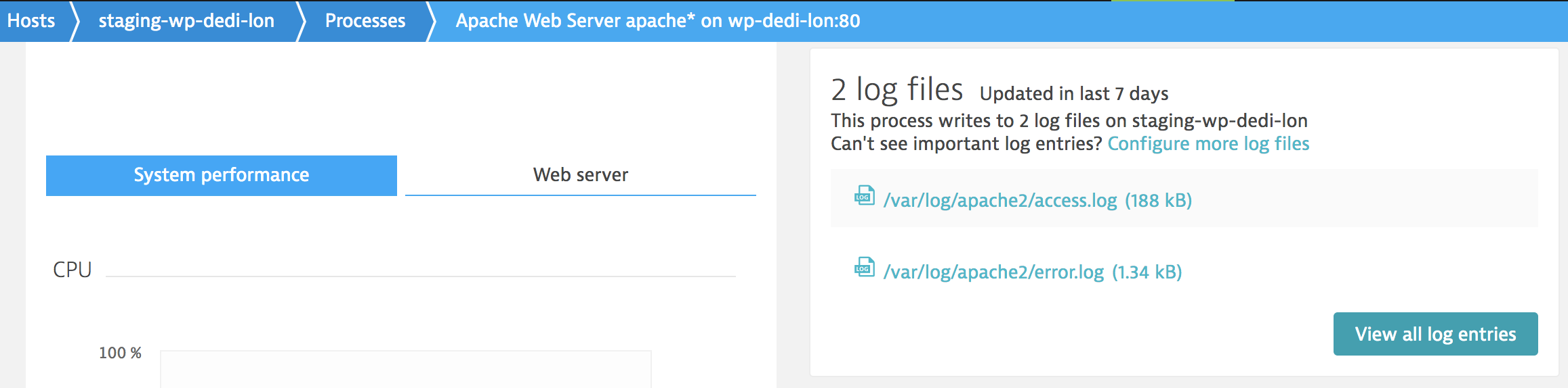

Otherwise like I mentioned, manually looking at the processes and its log file sizes; for instance in my own env staging :: prod
So you will just observe my prod version is larger (probably expected) but it is not tracked over time.
