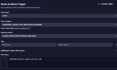

Option 3: Tweak your Davis problem trigger by adding a filter with
isNotNull(root_cause_entity_id)
which should also give you access to the name directly via the attribute
root_cause_entity_name
