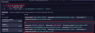

20 Sep 2024 01:38 AM
I think I'm on something... can I use this as an event to trigger the WorkFlow?
20 Sep 2024 02:01 AM
This one is a billing event which does not correspond to "Ei I have received data"
