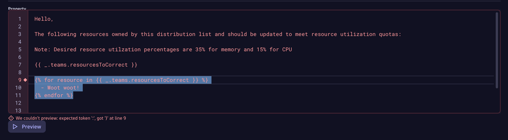

"Error evaluating 'content' in input. expected token ':', got '}'
Use the expression preview in edit mode to review the input."
I'm not sure why it's expecting ":", as this is not suggested in either the Dynatrace or Jinja documentation. With that said, I realize Dynatrace does not have examples for using a loop item in a Jinja for-loop.

The Jinja docs seem to indicate that the double curly braces are akin to a 'print' statement that would be used to insert a string to the actual output.
  • {{ ... }} for Expressions to print to the template output
As such, I think the fix may be to not use the double curly braces inside of the for statement.
{% for resource in _.teams.resourcesToCorrect %}
- {{ resource.name }}
{% endfor %}
This is also how the examples are written in Dynatrace's docs.. The output of previous workflow steps is referred to directly without being enclosed in the double curly braces.
