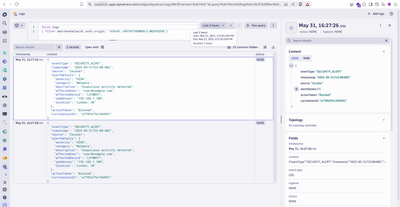

31 May 2025 03:39 PM - edited 31 May 2025 03:40 PM
@MarwanC  204 response code means the data has been successfully ingested.
You can lookup the log entry for example by the API token it was ingested with (just the public part):
fetch logs
| filter matchesValue(dt.auth.origin, "dt0c01.JUR2SVT6KBWHDJ7JWERHQ5UB")
If you still can't see it, please verify:
Actually, it's not important to know the payloads in advance; that's where the power of Grail comes in. You can just ingest it (maybe easily enrich it by adding log.source or some other data) and you can parse the content on query.
This is the curl example of yours in my environment (I just pointed it to my environment and used my API token. I executed the curl twice, that's why you can see two records here.
31 May 2025 05:31 PM
Indeed thank you, I knew my data were ingested but did not search in an efficient way - thank you
