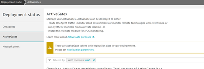

At the second step of the Documentation, it mentions that ActiveGate capable of AWS Monitoring.
https://www.dynatrace.com/support/help/shortlink/aws-monitoring-guide#capable-activegate
it gives many examples of AWS URLS, as well as endpoints.
Did anyone knows that where could i check this setting or where could i setup those endpoints?
is it reachable from the webUI? (manu> deploy status > activegate> setting )
or i should do some changes within the files under the activegate Directories?
thanks in advance,
Marcos
Hey,
you just need to ensure the endpoints are reachable from the ActiveGate hosts which have the AWS capabilities enabled. You can see list of such ActiveGates in the Deployment status:
Those endpoints must be reachable from the ActiveGate hosts.
