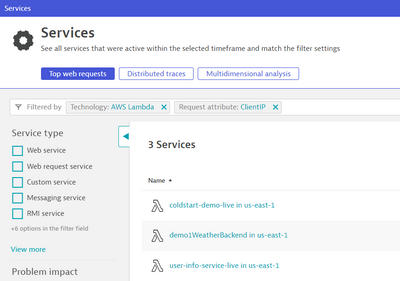

Hi All, looks like the documentation needs to be updated to specify only method level request attributes are not supported, I have informed the product manager
After speaking with the Dynatrace Product Manager responsible for AWS Lambda, he confirms that  your teams should be able to create all types of request attributes from the UI and have them be captured for Lambda Functions except for method level attributes. Method level request attributes would require OpenTelemetry.
See the screenshot showing request attributes captured for lambda functions in our demo envrionment.
