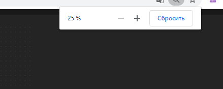

when we create dashboards with a lot of widgets, it may appear a glitch.
when moving widgets on the dashboard, it may happen that the widget does not want to move and lights up red, although in fact there is a place for it there
I noticed that in the chrome browser, dashboards are perfect built with a zoom of 50 or 25%
