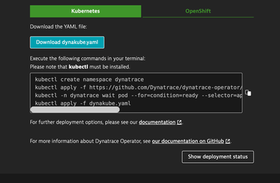

I'm Facing this issue after running kubectl apply -f dynakube.yaml
Error from server (InternalError): error when creating "dynakube.yaml": Internal error occurred: failed calling webhook "webhook.dynatrace.com": failed to call webhook: Post "https://dynatrace-webhook.dynatrace.svc:443/validate?timeout=10s": no endpoints available for service "dynatrace-webhook"
I following this step

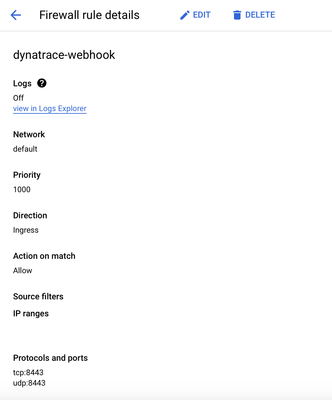

after searching they say that I should create firewalls rule ingress to port 8443. I do. but the error still the same.
this is my firewall rule configuration
please help..

Hello is your port 443 also open ? The url that you gave "https://dynatrace-webhook.dynatrace.svc:443" is set to port 443, check that your firewall allow the 443 port.

Thanks for your reply. I create firewall rule with allow all but unfortunately it didn't work
I'm still facing this error
