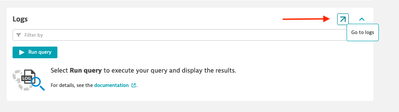

However, when we attempt to "Go to logs", the query it uses (shown below with IDs redacted) does not return any log records.

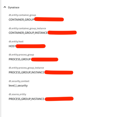

When reviewing the container log records, all of the dt.entity.container_group and dt.entity.container_group_instance values are null.

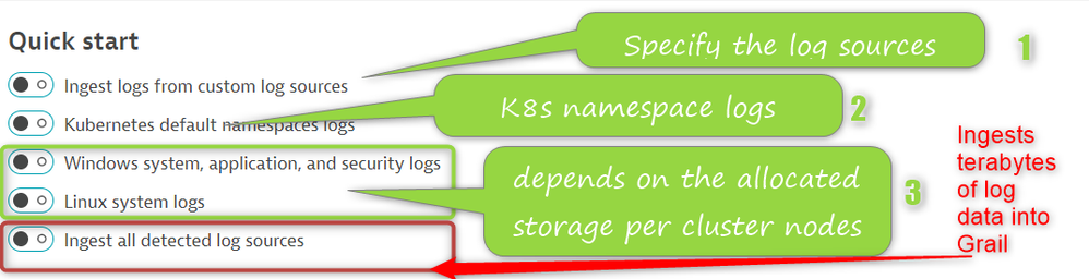

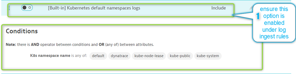

It's good to check if the log sources are configured or not
If you need to add custom log sources
On the environment level you can enable the below options as per monitoring requirements

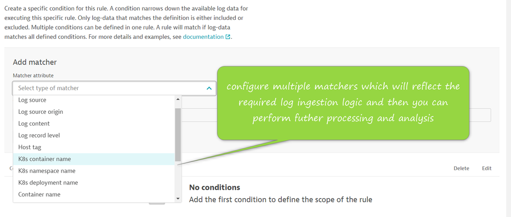

Hi @ASE
You have additional option to configure the below per each monitored entity

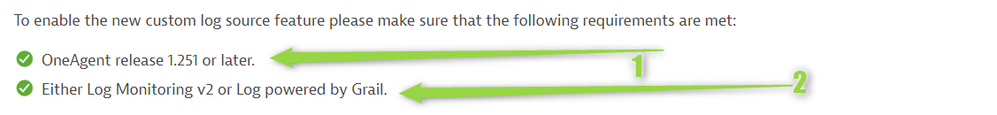

We're not letting OneAgent auto-detect log sources, therefore, some of the dimensions like dt.entity.container_group and dt.entity.container_group_instance are not being populated.
I also just noticed that our logs are missing some of the Docker Metadata:
https://docs.dynatrace.com/docs/observe-and-explore/logs/lma-log-ingestion/lma-log-ingestion-via-oa/...
I'm trying to determine why none of these fields are visible and/or populated when I click on one of our container's log records.

We did not enable any of Kubernetes features mentioned in the screenshots below, as we are not using Kubernetes.
