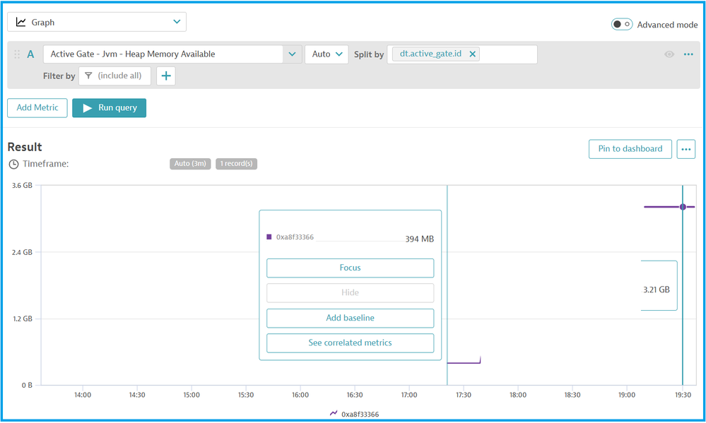

Hello @Michael_M
This thread for me is very interesting, bcs Dynatrace :dynatrace: + kubernetes  ❤️ I’ll do everything I can, whatever it takes.
There is two ways to do this:
First - If you prefer Kubernetes Hard Way (Joking 😃) Second - GitOps is everything.  (So true 😋)
Results: Memory [maxMemory=5521M, initHeap=3072M, maxHeap=5521M, usedMeta=14M, committedMeta=15M, totalPhysicalMemory=6144M, freePhysicalMemory=6031M] from your values  [maxMemory=1536M ...
resultsresults

Hi Aleksandr,
that was exactly what I was looking for.
I set the environment variables in my dynakube an the activegate use the memory how I want it to use.
