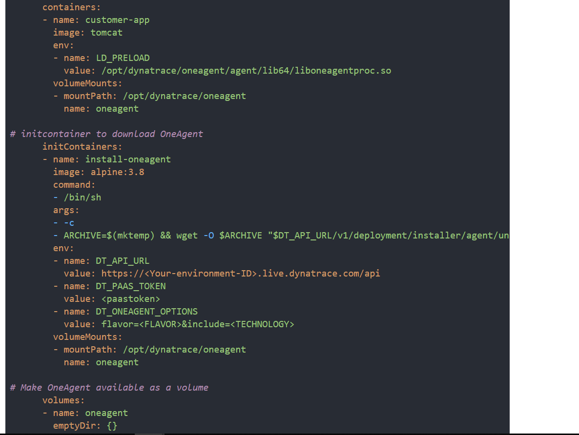

You should have yaml script responsible for container startup. There you should paste extra configuration according to documentation. This is all you need to do, than you will have no need for building images each time. This is old way of instrumatation.
Sebastian
27 Jun 2019 04:27 PM
Hello sebastian,
I created a file yaml in the project and i inserted into it the template below with replacing
the value, the tocken ,environement id , the option par the right values.

Seems ok but you have to add proper
Parameters like API url, PaaS token and API key. Without this your script os not able to download OneAgent, install it and instrument process.
All details are in documentation I’ve pasted.
I don’t have access to computer for checking but in tank important are indents in row. If you will have any errors be sure that everything has right indent 🙂

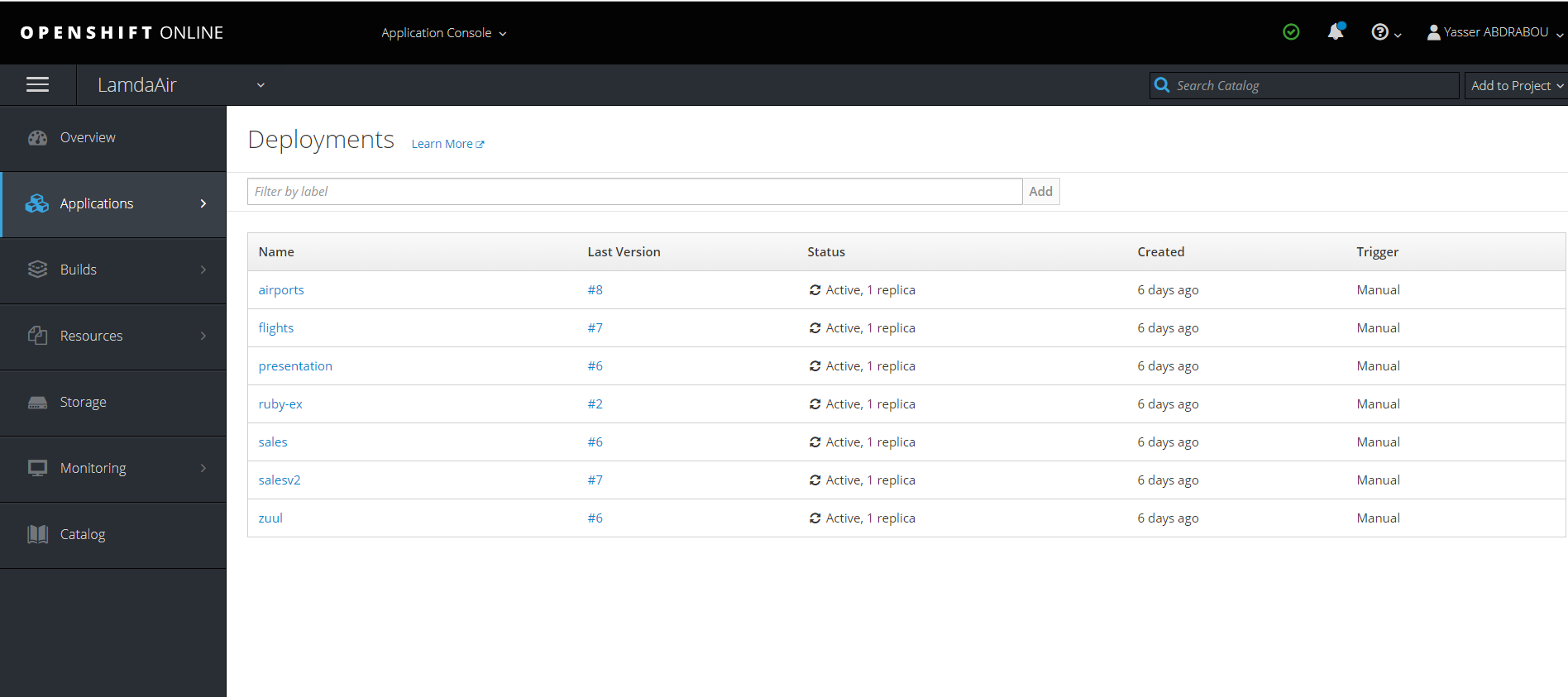

thanks but where can i find the yaml script .
you find below the screenshot for the application deployed on openshift online with the different service.

In fact, when i acceded to the interface of the openshift where the application id deployed , i consult the different services
firstly, i consult the airports service and i found the yaml file belowmy questions are:
the modification in the documentations should be inserted in this file
knowing that the application contains services, should i modify the yaml file for each service
best regards,
Refka
