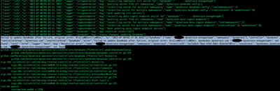

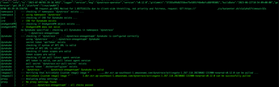

I have recently updated the dynatrace to v0.12.0 and that onwards oneagent injection not working. Troubleshoot command says all good and activegates pods are up n running. I can see the kubernetes metrics in dynatrace and pods also have init container injected but hosts are not connected to any activegates.
refer the snapshots below
Error in dynatrace operator
result of troubleshoot command
