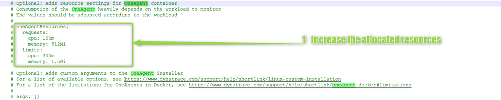

Hello @Marwa , @NavenduGupta
Regarding the highlighted error simply increase or re-adjust the allocated oneagent resources.
By default, it's presented in Dynakube.yaml file
After increasing the allocated resources for example to 2x or 3x it should work as expected without issues.
KR,
Peter.
07 Oct 2024 09:07 AM
@Peter_Youssef i noticed that the issue was because of classicFullStack vs cloudNativeFullStack mode. By default, in the dynakube.yaml file, OA was getting installed in cloudNativeFullStack mode. I changed it to classicFullStack model and it started working...
I'll try your solution in the cloudNativeFullStack mode and get back.

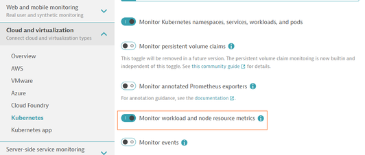

@NavenduGupta , can you please check if the below is enabled on your side?
Please ping me directly when you are free, we can take a look at it together if possible .
