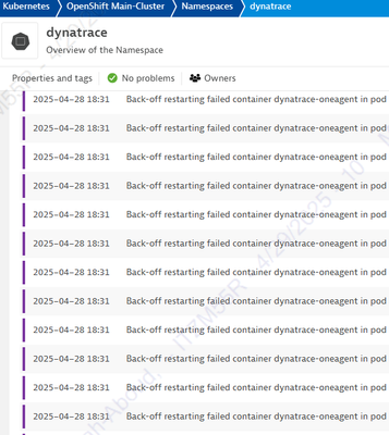

We are experiencing an issue in our OpenShift environment where multiple pods belonging to the OneAgent DaemonSet are stuck in CrashLoopBackOff state.
Details:
Dynatrace Namespace: dynatrace
Workload Name: openshift-main-cluster-oneagent
Workload Type: DaemonSet
Issue Observed: Multiple pods are continuously crashing and restarting (CrashLoopBackOff).
Request:
Could you please assist in identifying the root cause and recommend the necessary steps to stabilize the OneAgent pods?

Hello @PacoPorro @pawel_harbuz ,
As Dynatrace support feedback, the issue is due to Dynatrace opearator Version 1.5.0 has a Bug.
so, we have to upgrade it to version 1.5.1
