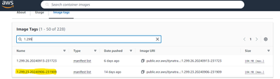

The Image of Dynatrace active gate image we have used is below highlighted.

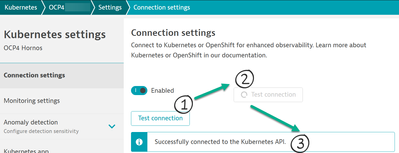

Dear @DanielS ,
Thanks for suggesting we have checked Test connection is showing successfully connected.
Connection status is also showing ok, we have 2 containerized AG below are the details of Namespace and PODS.
for your information We have 2 OpenShift which we have integrated with Dynatrace one is working fine no gaps but yesterday we gave integrated with another one which is showing this gap problem.
Thanks
Dharmender
