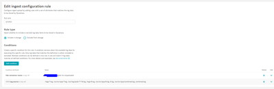

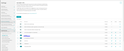

Hello community, I have the following issue; for some reason, I'm experiencing a lack of log ingestion. My environment is 100% based on Kubernetes.
my ingestion rules are :
and the winson rule are this.

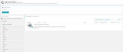

The pods exists
and the log to !!
Please i need HELP !!!

It was indeed a configuration issue, as I didn't have the rule specifying the namespace or cluster to search in. The 'all logs' switch was not turned on, so the rule alone wasn't working. I added the namespaces and now it includes all application logs.
